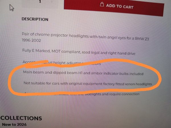

With regards the bit I've circled
Does this mean they are led bulbs (included)
On my 02 I'm assuming it doesn't have xenons ??
I picked up a used set of those a few years back. They use standard bulbs and I personally didn't feel they were very good quality.
