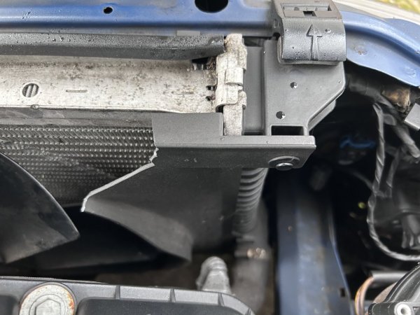

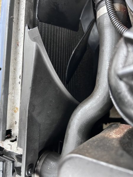

Water pump pitched and wrecked the Fan Cowling so after a new/used one.

I may be wrong, but does this also happen if your engine mounts are shot and the clearance of the fan to the cowling and radiator becomes too small?Water pump pitched and wrecked the Fan Cowling so after a new/used one.
Yip.. and/or your transmission mounts ..best to do the lot in one goI may be wrong, but does this also happen if your engine mounts are shot and the clearance of the fan to the cowling and radiator becomes too small?
